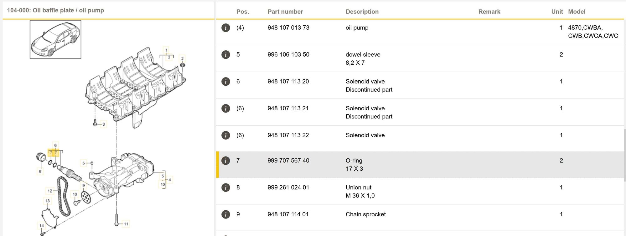

Am I correct that in the photo bellow sensor is pluged in into flange no.21 ?
What for is this sensor ? I don't have any faults or incorrect readings, just a small oil leak, it is a bit difficult to determine from this layout diagram which one it is...
Originally Posted by ciaka
DIAGRAM of sensors locations - for your reference:
Thanks in advance.
Found it :
https://www.6speedonline.com/forums/...id-change.html
this is solenoid valve for oil pump and it wasn't on that sensors layout diagram ....
in my case to stop oil leak through it and other weepings plus to change oil I will need Porsche OEM parts:
No.7 from this diagram: 2 o-rings for the solenoid 17x3 part no. 99970756740 - 2 x 2,36 eur
No.19 from previous diagram: 1 o-ring 44,0x3,0 for the flange part no. 99970757040 - 4,57 eur
No.14 from previous diagram: 1 gasket for oil sump, part no. 94810727521 - 37,60 eur
No.16 from previous diagram: 1 seal ring A18x24 for oil drain plug part no. 90012310630 - 1,47 eur
No.17 ( can be used instead of no.3 ) from previous diagram: 7 (just in case...) flat round head bolt M6x20 part no. 99907334401 - 7 x 0,91 eur
