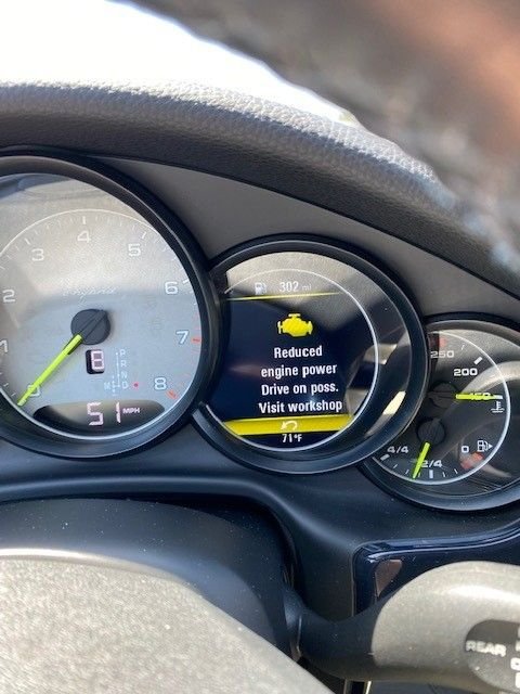

Old May 21, 2021 | 05:56 PM
dougcayenne's Avatar
Joined: Jun 2015
Posts: 528
From: los alto, california
Rep Power: 34
dougcayenne has a spectacular aura aboutdougcayenne has a spectacular aura aboutdougcayenne has a spectacular aura about
Charge battery full to test the brake in emode. I don't see I have a problem with brake. Brake problem when engine is running, strange. On my way to Costco I see the message reduced engine power light up. Terrible ... Bring the car back to Porsche. It may be time to trade in. Porsche Hybrid value is lowest to trade in. My Pan is PP+, PDLS+ and ACC Lidar.

I just found I have brake booster issue with my durametric diagnostic today. "reduce power engine light" message was on yesterday during my drive to costco. I have an appointment with Fremont Porsche this coming Friday, I see $$$ pain. I will complain to Porsche America.
I just found this posting below from @pishter. my 2016 Pan Hybrid has so many issues starting mid 2020 to now. I did not drive much 2020. Hybrid is so buggy and not reliable. I am planning to trade it in for sure. My other 2 ICE Porsche are solid.
The sad thing is I just had a brake bleeding done at Porsche 2 mos ago. They did not report this issue.
Dealer found out that hybrid system has went into a ‘Safe Mode’ due to a fault in the brake booster vacuum pressure sensor.
The tech found a stuck one-way valve for the vacuum system in his diagnosis.
There is a technical bulletin regarding this concern and it directs them to replace all three vacuum lines. In addition because the pump has overran trying to compensate for the stuck valve, they will replace the pump and the relay that controls it as well.

No Cost, Porsche is taking care the issue. brake booster vacuum is leaking, replace a vacuum line. Pan Hybrid is the most unreliable car I have. The car is 44K miles. I am working to trade it for a new 911. I see 911 retain the value very well.
